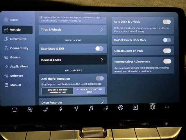

The first interior pull unlocks the door (also presenting the exterior door handles) and the second pull unlatches it.My issue has been exiting the vehicle. It almost always takes two “pulls” on the trigger for the door to open. Going to have service address this ASAP.
You can configure this behavior by enabling unlocking the doors when shifting to Park. Then the handles will present when shifting to Park, and the first interior pull will open the door.
