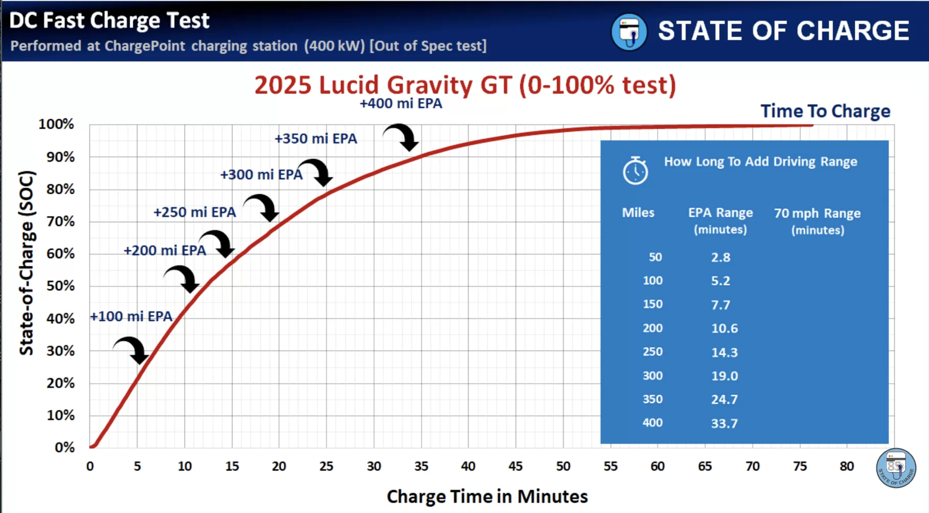

State of Charge has a new video out on their perspective of the Eastern Edge race. I grabbed this screenshot from a 400kW EA charger:
He did it cumulatively, but I was more interested in incremental, so:
Starting SOC (approx.)Time to add 50 EPA MilesAvg Time Per Mile
0%168 seconds3.36 seconds/mile
11.1%144 seconds2.88 seconds/mile
22.2%150 seconds3.0 seconds/mile
33.3%174 seconds3.48 seconds/mile
44.4%222 seconds4.44 seconds/mile
55.6%282 seconds5.64 seconds/mile
66.7%342 seconds6.84 seconds/mile
77.8%540 seconds10.8 seconds/mile
I was interested in finding the optimum point to stop charging and go to the next charger. Obviously, while the charging rate slows down (as much as a factor of 3.75!), the time from off-ramp to on-ramp also matters (time to get to charger, park, get out of car, plug, get the handshake going until actual start, then the small ramp-up time as the charger modules kick-on), then un-plug, get back in car, and drive to the on-ramp (including traffic lights both ways).
Let's say the ideal starting charge is below 10%, but above 0% (you can go lower due to the buffer), and choose a 2.9 seconds/mile number. At 56% (Tom's ideal stopping charge), you need 5.64 seconds to get a mile. That's 2.74 additional seconds/mile to keep charging instead. If we want to go from 11 stops on the Eastern Edge Race to 10 stops, well, let's look at the data:

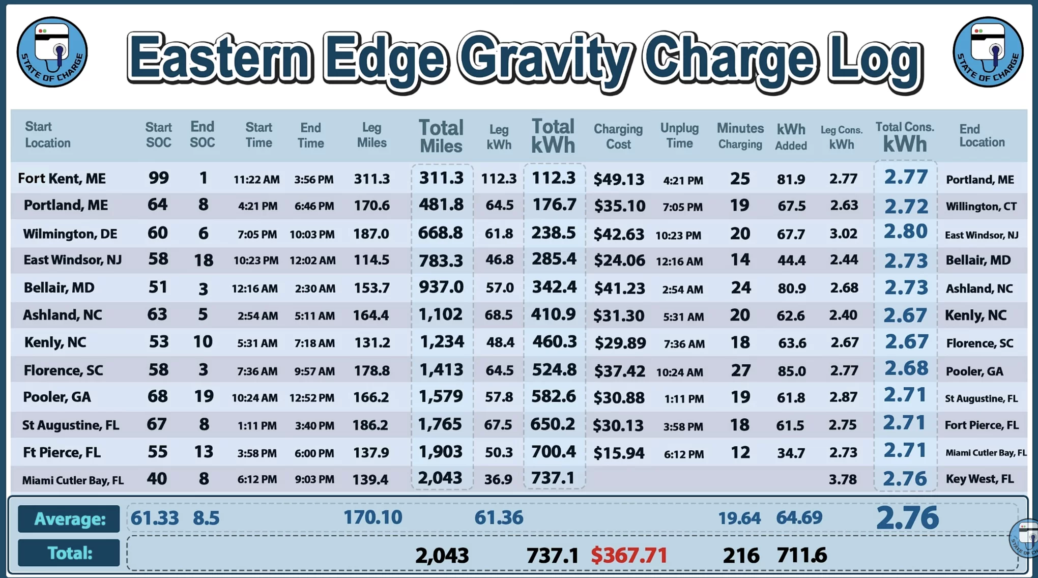

First charge doesn't count for on-road charging, so they added 624.8 kWh on each of 11 stops. If we wanted to do 10 stops instead, that would mean adding, on average, 62.4kWh per stop instead of the about 57kWh per stop they actually did. That's a difference of about 5.4 kWh additional. At 2.7 miles/kWh, that's 14.6 additional miles needed.
Tom shows a chart and decided that 57% SOC was the ideal stopping point - and they came close to averaging that. At 57% SOC, staying on for 5.4kWh would add (14.6miles*5.64seconds/mile) 82.3 seconds per stop. Times 10 stops and that's 13.725 minutes. So, if they could do their stops with an average down time of less than 13.725 minutes, then Tom was right.

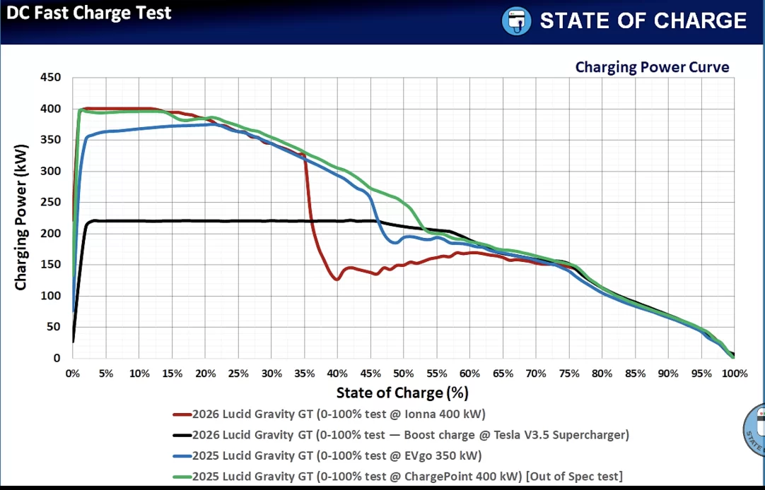

My original point in posting was to move beyond Tom's assertion that 57% (or thereabouts) was the right point at which to stop charging. IIRC, he based that on this chart:
Where his vehicle was restricted to the black line, in which charging ramps quickly to 225kW (0-2%SOC), and then stays there until 45% SOC, and even at 57% SOC is still pulling 200kW, but then starts slowing down more rapidly. My goal was to figure out if they had held out until 75% SOC, which is another inflection point of charge rate (but still pulling 150kW) is that additional 23% of additional SOC (27kWh?) per charge would have resulted in them being able to remove a stop or two, and then whether that slowing of 50kW for that last bit was worse or better than the per stop downtime.
From what he says, I think Tom chose based on the graph's inflection points, and not on the actual time difference calculations, but I could be wrong. I do think the real math is more complicated, but worthwhile for the goals of this race.
