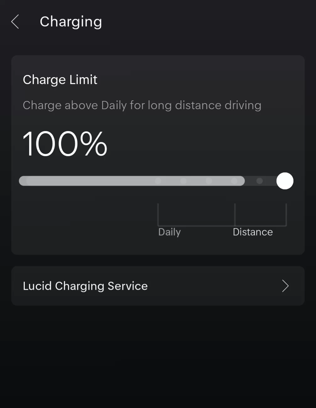

I'd really like to change the charge current limit from the Android app. I've seen pics with it in various posts, but I think they're all iPhone screenshots. Can iPhone users confirm they have that feature in the app? Anyone using Android able to set current limit?
There's no current limit setting visible in my Lucid Android app for the Air.

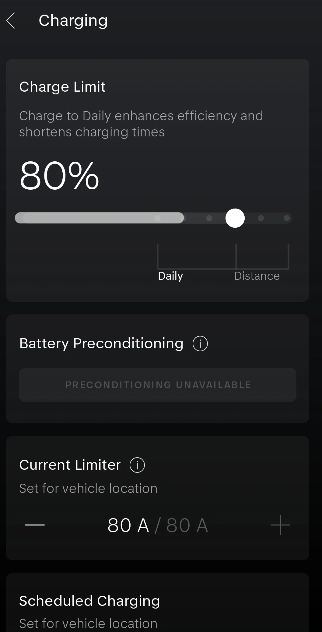

Android, with Gravity
That screen is visible when you click on the Charging panel from the home screen. It's a sub-panel. I also have the Gravity.
Yeah, from the screenshots I've seen that's where I thought it would be. Not for me though.

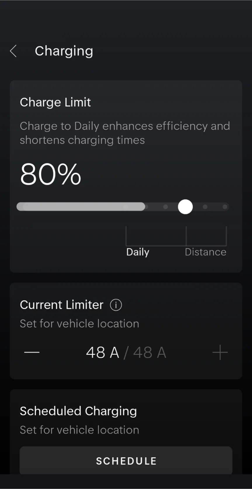

Air Touring with Samsung S24 ultra Android got it all when plugged on AC

Android Pixel Fold definitely has current settings:

Sorry, just check this morning and current limiter no more showing. plugged, unplugged nothing show anymore. I can swear I have it couple months ago and use it all (last) winter long to keep my battery warm has long has possible when the car slept outside. 2024 Touring on 2.8.17 checked on 2 Samsung phones, Note10 (Android 12 one ui 4.1) with Lucid app 2.11.0 (4265) and S24 Ultra (Android 16 one ui 8.0) with Lucid app 2.12.0 (4337). Oh! well, another 1 step up 2 step back for softwares. (Lucid, Android and/or Samsung whoever)
Sure seems like the current limiter is only available for Gravity on the app
As I said it use to work and as per my owner's manual version 2.8.17 it should !
Ok as per manual this is avail since 2.7.1 July 13, 2025 so my memory fools me that was probably for my Polestar but any way it should work on the app. 🥴
