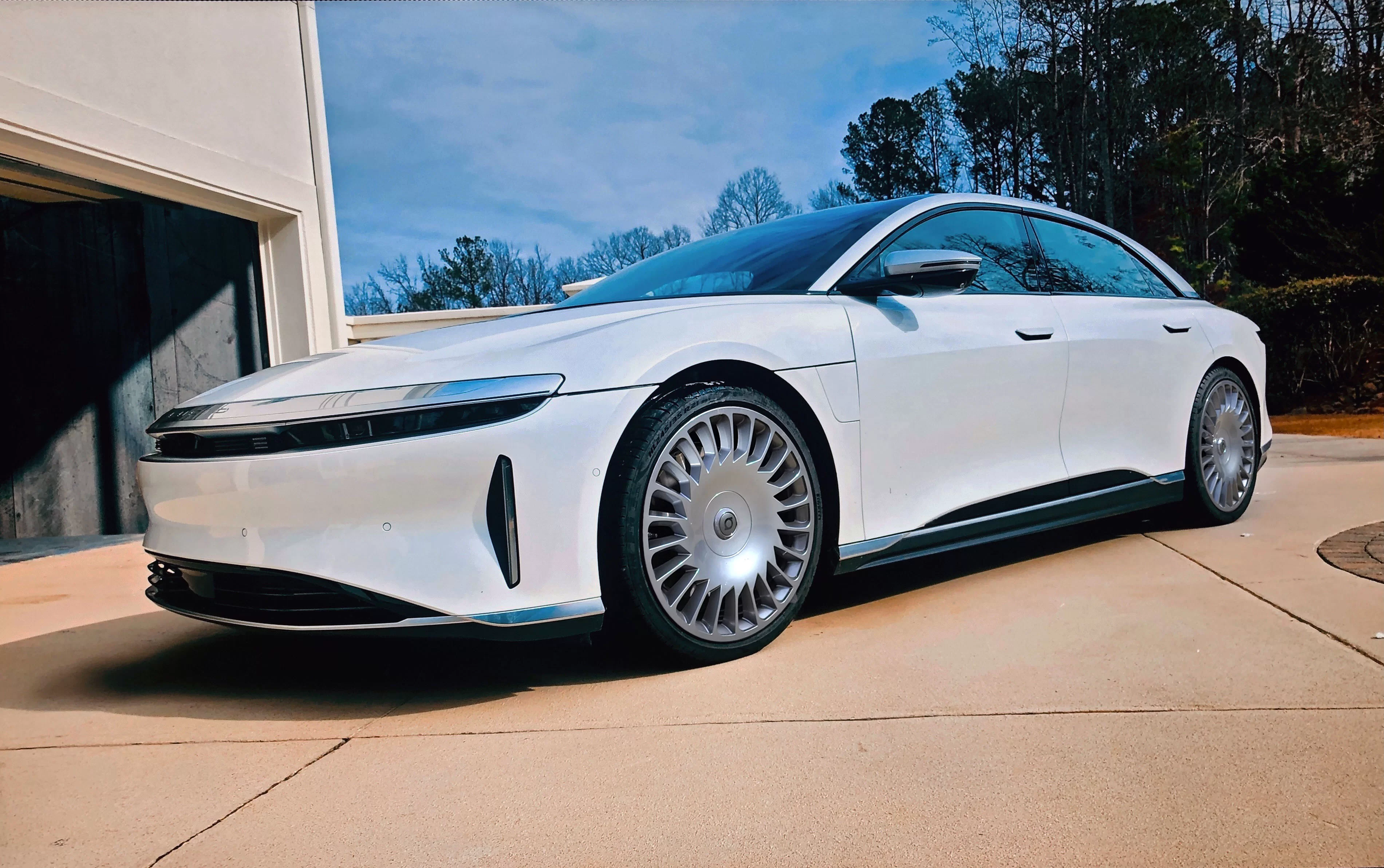

The 21" aftermarket wheels for Tesla Model S 2012-2020 works. Probably the 19" also. We are willing to sell a set with discount to test this. This is the 21". But we have 19" in the same design.
What is the price for 4 wheels with tires to fit Lucid Air Dream Edition? and how to contact you? Thanks.
Hi! I will set up a thread in the vendors section. But meanwhile: order from thenewaero.com and use the coupon code "lucidowners" for 10% discount. In the checkout you will see all costs specified including shipping and your state tax. From what I can see the Dream Edition is delivered with 21" so you can actually swap the tires from them to our wheels.
Link to the specific set in the picture 21" Glossy Titanium. We only sell the rims. If you are located in California or Florida we have some resellers but not in other states.
Actually I am looking for 19" wheels with tire for DE.
Ok, I can not say if they clear the brake calipers. What we can do is I ship them first, and you try them. If they fit we process the payment. If not we return them.
Our 19x8,5" for Model S is the one we should try. Tires 245/45-19. We have Satin black and dark silver colored.
Hi! We know that they fit now so the offer is no longer valid. Regiular price 2299 $ per set + tax and shipping
