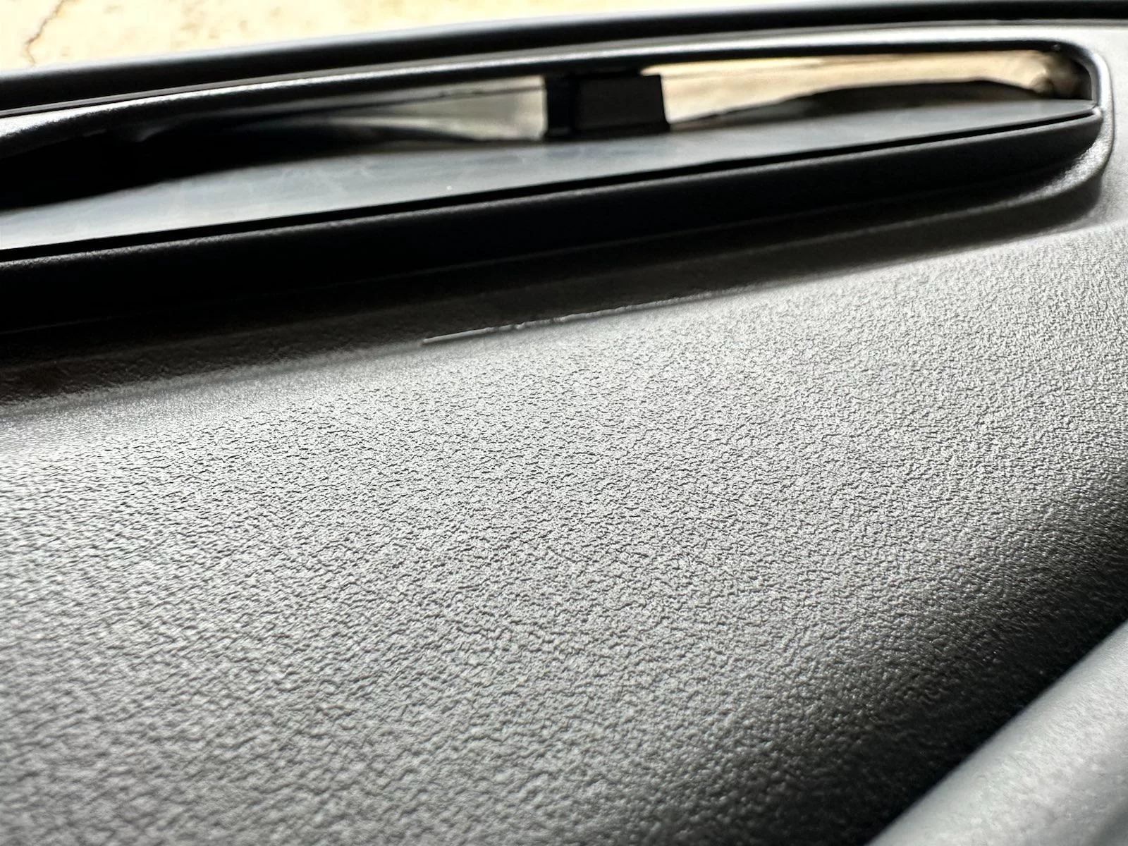

Speaking of the headlight air channels, I noticed that the driver's side has this rubber block in place and it's not there on the passenger side. Can anybody else please look to see if these exist in their cars?

To circle back on this, I found the culprit by taking my electric leaf blowing and blowing around the front of the car. The problem is the rubber membrane you see in the headlight air channels when you open the frunk. The driver's side is catching air in such a way that it makes the sound, kind of like a whoopie cushion. I'm curious if that rubber block in the pic above has something to do with this. Putting it in to support.

The rubber block actually looks like a shipping piece that got left in the car.

My service guy said to leave it and they'll remove it, something about it being part of the light bar. Hopefully it's something that can be done remotely. IIRC, a light bar replacement requires taking the whole front off which requires recalibrating everything at a SC.

It took them a whole 5 mins to fix it. All the did is glue small rubber rectangles in place to keep the flaps from vibrating. I haven't driven the car yet, but the leaf blower test was successful.
He also said the rubber block that's in the vent near the headlight (pictured in an earlier post) is to adjust the fitment of one of the parts around there.
