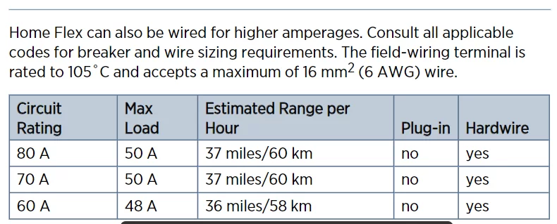

I bought the ChargePoint Home Flex charger and had it hardwired to a 60-amp breaker. You will get a little more power from hardwiring than plugging it in, the charger knows that it's hardwired.I am due to receive my GT in 10 days. I already have a 60 amp circuit with NEMA 14-50 outlet in the garage. Does it make sense to add a level 2 charger or just use the provided cord from Lucid?

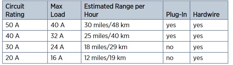

Code says that a 14-50 can’t be on higher than a 50A breaker. You should fix this, or just hardwire a charging station like Wallbox or Chargepoint or Juicebox or any of the others so you can get the full 48-50A on a 60A breaker.I am due to receive my GT in 10 days. I already have a 60 amp circuit with NEMA 14-50 outlet in the garage. Does it make sense to add a level 2 charger or just use the provided cord from Lucid?

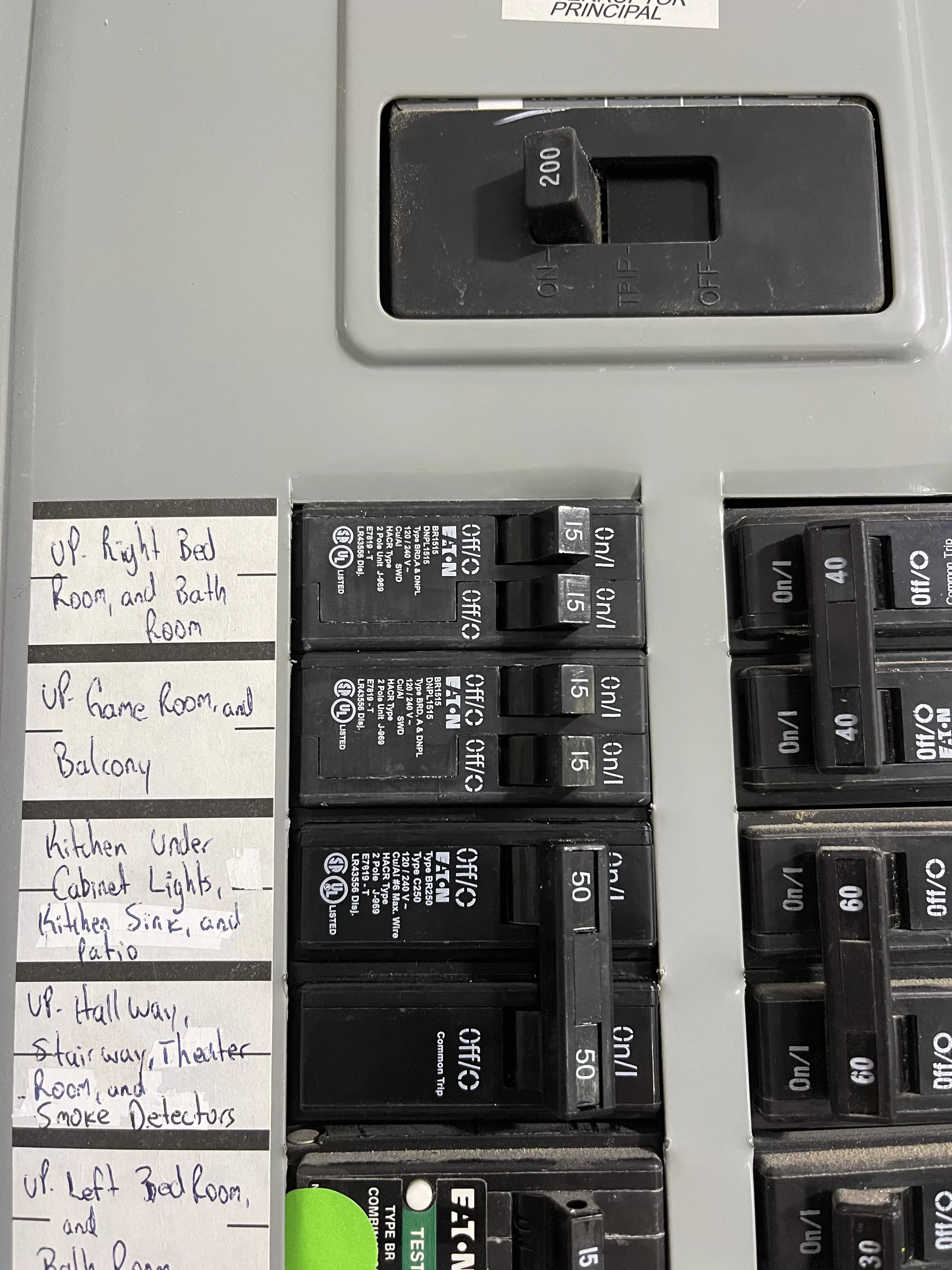

I have a 200 amp breaker box with no more slot open. The electrician took out 4 breakers from top left corner and merged them into 2 breakers with smaller switches to yield 2 slots for my Wallbox hardwire. I see 50 amp x 2 switches, does this mean I am running on 100 amp? I see Wallbox app max amp is 48. I set that setting and getting 11kW/hr.
The important part is what size breaker the Wallbox is on. Is that the 60amp breaker on the right? If so, you’re all set. If it’s a 50-amp, I’d see about swapping the breaker to a 60-amp, assuming the wire and panel can handle the extra 10 amps.Question?! (I’m clueless about electrical matters)
The two new breakers added are 50 x 2 slots. Which Wallbox use. The right side 60 x 2 slots Ali’s for my downstair HVAC.The important part is what size breaker the Wallbox is on. Is that the 60amp breaker on the right? If so, you’re all set. If it’s a 50-amp, I’d see about swapping the breaker to a 60-amp, assuming the wire and panel can handle the extra 10 amps.
This makes sense. I see cooktop is 30 x 2 slots, space, so cooktop is basically on 30 amp.You do not add the two breakers. You have one 50 amp. breaker on the “A” phase at 110v and the second 50 amp. breaker on the “B” phase at 110v. The two phases are why it is “alternating” current and not direct current.
If the wallbox is on a 50 amp circuit, it must be set to charge at 0.8 * 50 amps = 40 amps maximum per code.The two new breakers added are 50 x 2 slots. Which Wallbox use. The right side 60 x 2 slots Ali’s for my downstair HVAC.
But Wallbox app says max amp is 48, so I should be safe right?
I just email to QMeruc to update those breakers. Thank you for this info!If the wallbox is on a 50 amp circuit, it must be set to charge at 0.8 * 50 amps = 40 amps maximum per code.
