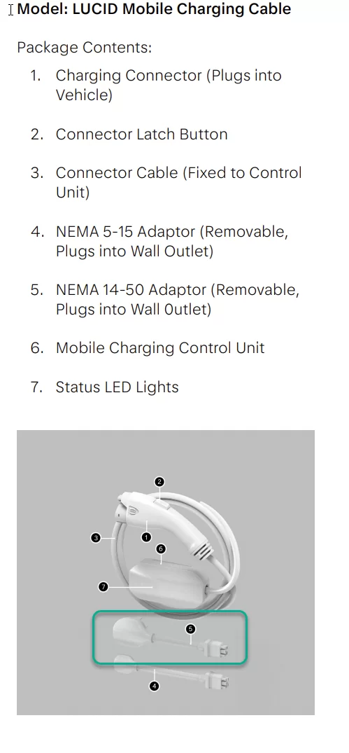

My understanding is that the building he works has 14-50 outlets on 20A breaker available for EV charging use while parked. This setup is the source of the problem.
He is using the lucid supplied portable charger and the plug attachment it came with (14-50).. Another adapter is NOT in the loop..

The Lucid charger only has 2 240 options at this time. 14-50 plug that will draw 40 amps and the 14-30 which will draw 24A. Lucid does not currently have software capability to set a lower limit. It is possible, but unknown if they will ever implement.
Below is a link for a third party charger that allows you to manually set a lower AMP draw.
And this setup is against standards as 14-50 is supposed to provide up to 50A
