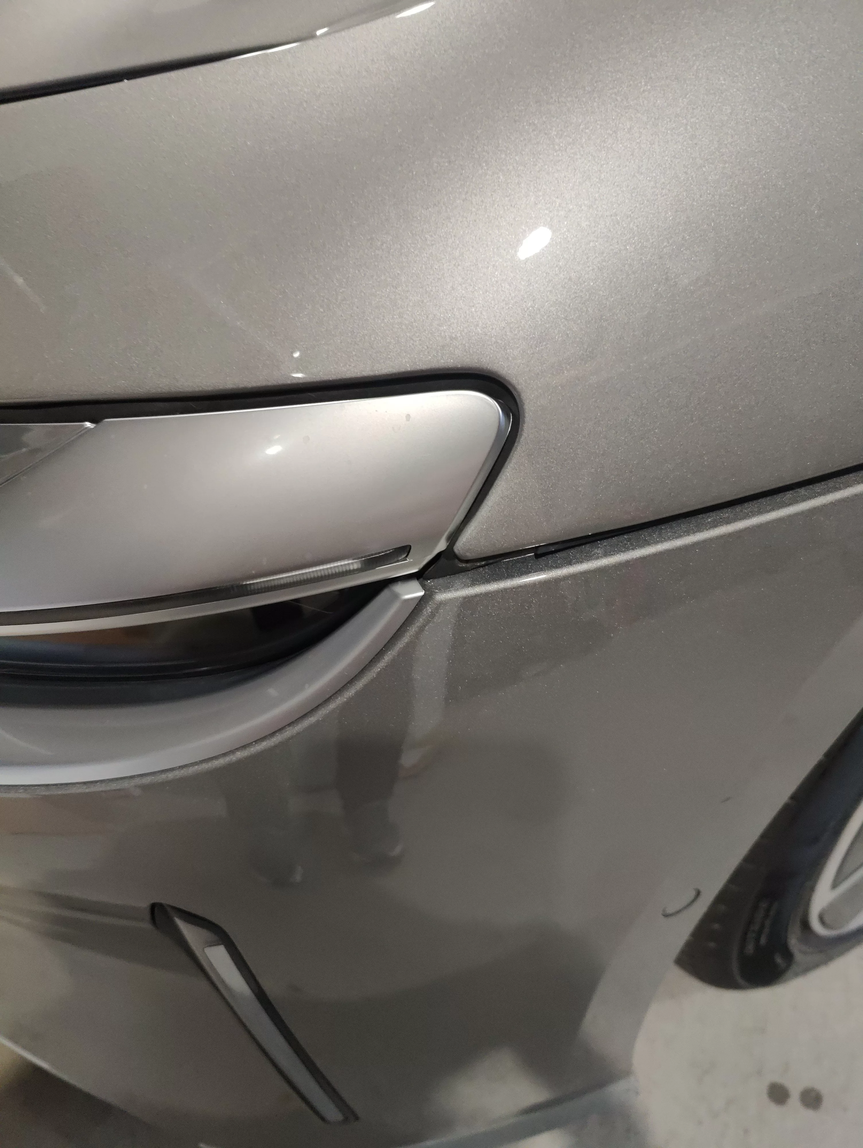

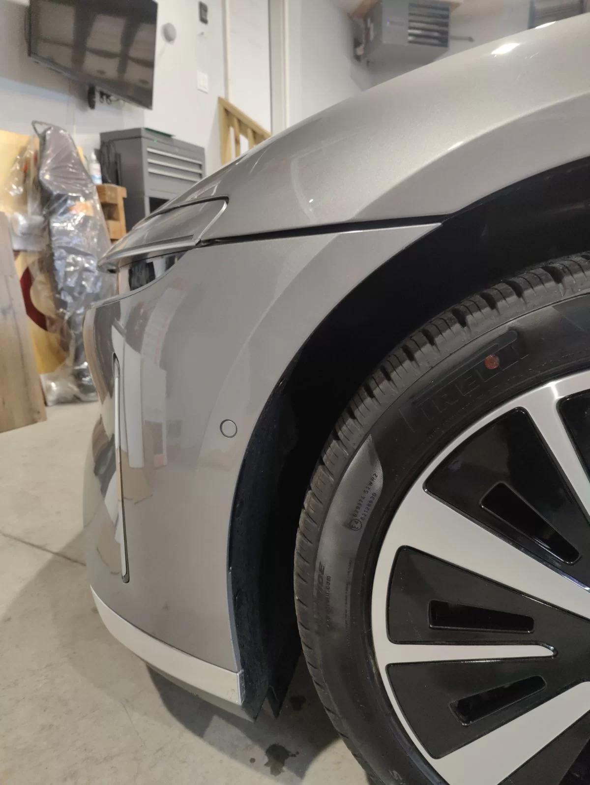

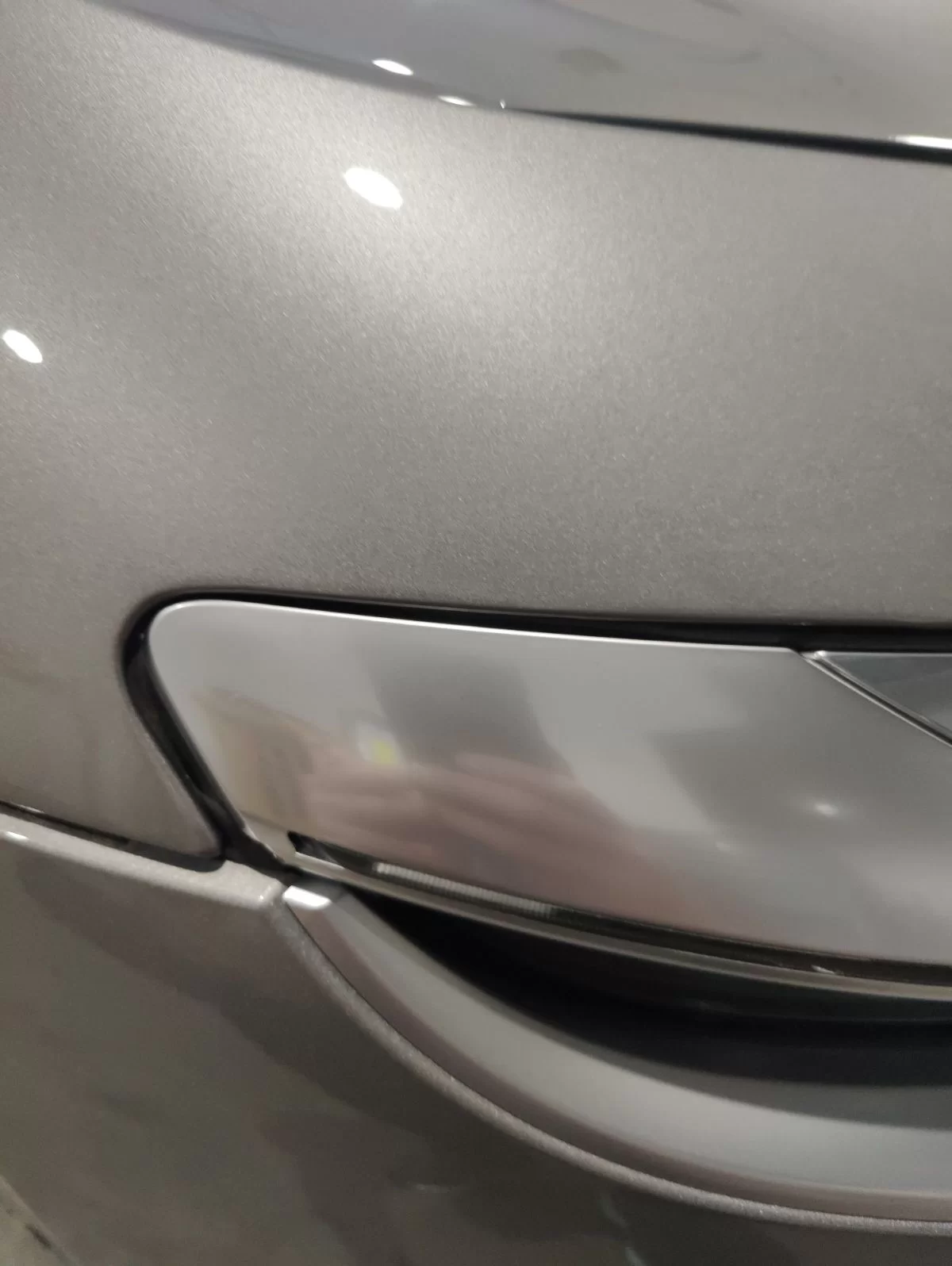

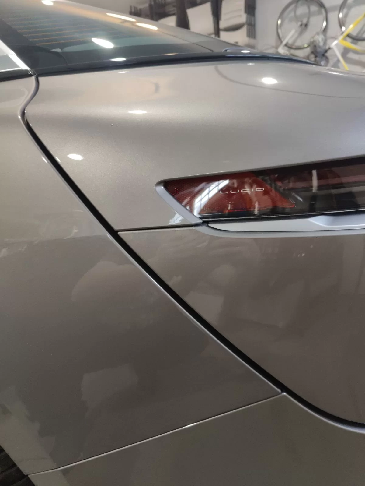

However, I had my phone walkthrough with Lucid and brought up several panel gaps. He agreed that they seemed quite off. Hopefully they can get fixed. How bad are these attached photos? Is it just me?

I do not think that is just you. Those gaps look bad. What did they say when you asked to get it fixed?
He documented everything when I sent pictures and said he wouldn't be satisfied if he paid that much for a car either. Filled up the "due sheet" that documents issues that need to be fixed.

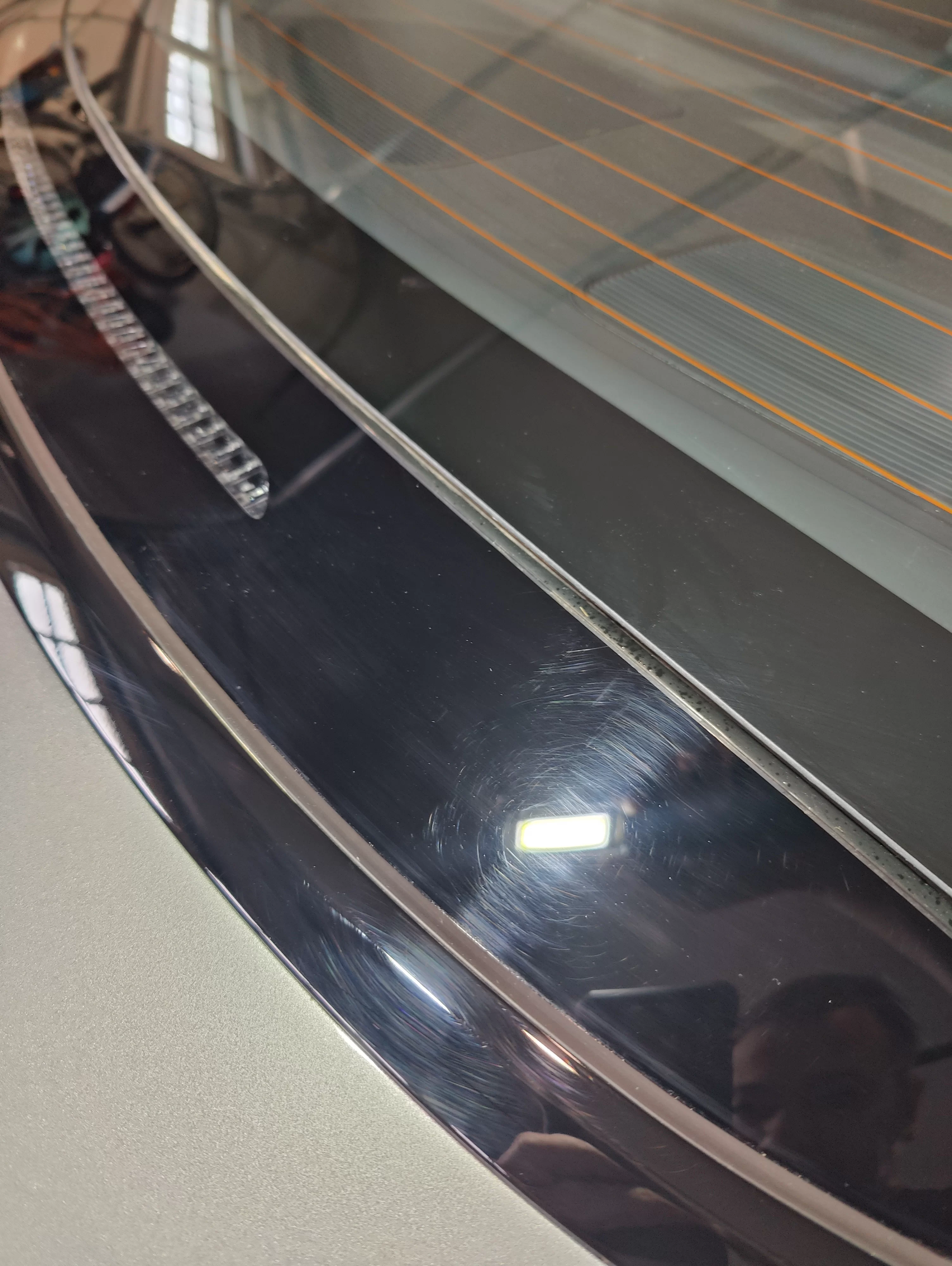

One interesting thing was the back tail light plastic between the trunk and the window. Tons of swirl marks from when they must have been polishing. I feel good that they will fix the issues, just sucks that I'm in MN and not sure if it will have to be shipped to Chicago.
The gap on your front bumper is excessive, they should fix that. The gap at the trunk, while not wonderful appearing, is very standard due to the way the trunk seals. I think mine is slightly wider at the bottom. I expect they may redesign/retool the trunk lid in the future, that’s just the way it is now, and it won’t leak. For the profile log-in, maybe reset your password on the Lucid site first, then see if you can log in to the car, then try and log in to the phone app and see if you can pair your phone as a mobile key? If you have the mobile app up and working, text service and explain you cannot log into the car no matter what you try and see if they can walk you through stuff over the phone?

They were just documenting everything on the "due sheet". No word on when things will be fixed because we ran into an issue during the walkthrough where we couldn't log back in.

One interesting thing was the back tail light plastic between the trunk and the window. Tons of swirl marks from when they must have been polishing. I feel good that they will fix the issues, just sucks that I'm in MN and not sure if it will have to be shipped to Chicago.View attachment 11058
While I know you don't want the car shipped to Chicago; but I have to tell you the general staff the and techs working at Goose Island will do some great work aligning those front body gaps and whatever else you need corrected.
As others have stated the rear trunk lid does have a slightly wider gap at the bottom as compared to the top part of the lid, the techs might be able to balance yours out a little better.
